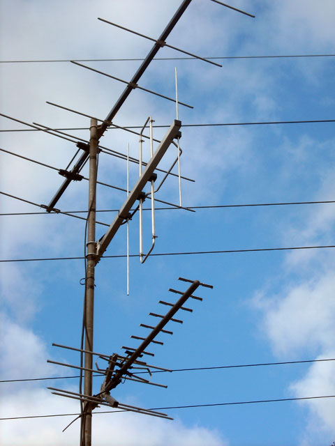

Photo: Antenna on mast.
To test the reception I temporarily mounted the G0̸KSC antenna on my roof. The upper antenna is a 10-element Yagi for TV VHF Channel-9, which pulls in Canadian station CBET from 29-miles away. The smaller antenna below is for my local UHF-band TV stations, all only a few miles away. The AIS antenna is aligned with the two other antennas to minimize any pattern disturbance.
Once I had assembled the antenna and connected a coaxial feedline, I made an educated guess for the dimensions of the loop driven element, and I checked the VSWR with the antenna held just a few feet above ground and indoors. The transmission line VSWR looked decent. I took advantage of some very mild Winter weather, and installed the antenna on a small mast on my garage roof. This put the G0̸KSC Yagi about 20-feet above ground and aimed at the Detroit River on a true bearing of 152-degrees. The temporary feedline was only long enough to get down from the roof, so I had to set up a temporary receive station outdoors. I sat down to see what ships might be passing by and what their distance might be.
